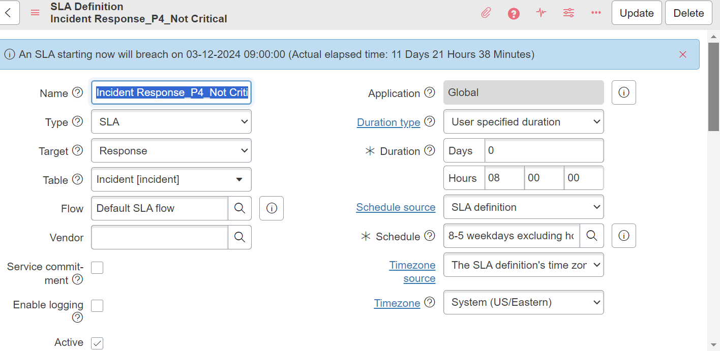

Hi, I have created SLA definitions in dev instance and it is working properly when creating a ticket but when I test in the test instance, I create a ticket and the SLA definitions aren't populating. All conditions are inserted and met on both instances. Does anyone know what could be the issue and how to fix? This is first time creating SLA definitions so all assistance is welcome.

Hi, yes, tested it as P4 with business criticality as not critical. Tried changing from CI.Application Service.Business Criticality to Service.Application Service.Buisness Criticality and still no task SLA populating with all matching conditions.
