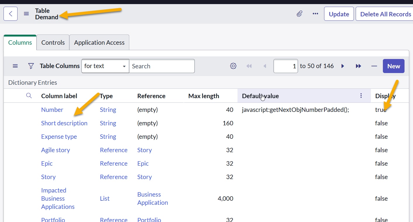

I have reference Demand Number in Project Tasks.
The demand shows Name instead of Number.
I have followed suggestion from other post enabled and set up dictionary over rides and enable display value for demand number.
I'm still unbale to get the demand number instead of Demand name.
I have attached screen shots of the dictionary overrides and demand columns display value.
Please help me identify and fix the issue.
Thank you in advance.

Your override is on the project_task_link table, and the Dictionary Entry for Demand Reference is on the project_task table, so I'm not following. In any event, Display values are inherited from the table that a table is extended from, so forget the reference for now, just view a record on the referenced table to see what the display value is, and if you want to change that go back to the table it is extended from until you get back to the root table.
