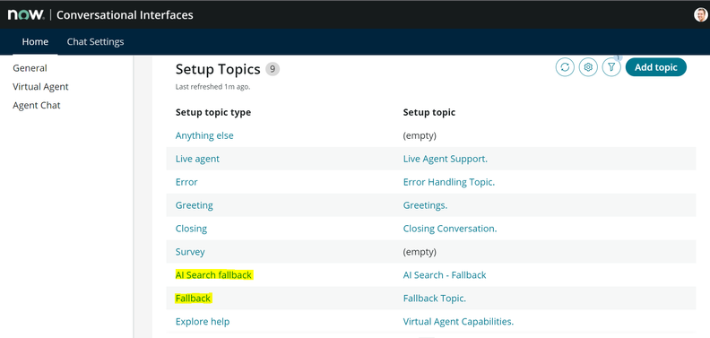

1. If what I write (let's say keyword or utterance ) which my VA doesn't understand (not configured in topic ) then I want it to automatically route it to the live agent either at the start of the conversation or at the point during the conversation.
Is this possible? - Yes, this is possible using AI Search Fallback and Fallback setup topics of Custom Greetings and Setup.
  • User enters a request or keyword but Virtual Agent can't find a matching topic or keyword, or finds too many topics to determine the matching topic: Virtual Agent runs the AI Search Fallback topic to generate relevant search results for the user, before displaying the Fallback topic. If you deactivate the AI Search Fallback topic, Virtual Agent runs the Fallback topic.

Hi @Manal AQUIL
Transfer to Live agent is a Topic block present OOTB as below:
We need to configure them in Topics or we can configure separate Topic just to connect to Live Agent.

@anubhavritolia Your answer makes sense but either using OOB -Transfer the live agent topic or creating a custom topic to connect the live agent will require the user to select from a list of topics or click contact support but I want to transfer in the below-mentioned scenario.
Is this possible?
2. When the conversation is transferred to a live agent, do they receive a notification or they are notified?

Hi @Manal AQUIL
Firstly, wanted to correct that we cannot use 'Transfer to Live agent' topic directly as this is Topic block and not Topic. So we have to call it in another Topic and use.
Find my comments below for your queries:
