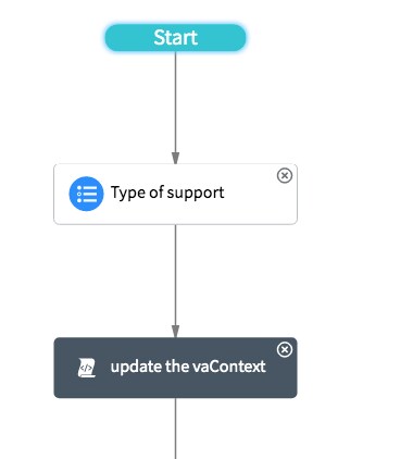

06-03-2022 04:39 AM
HI Alessandro,
Can you try this,
In this case, you wanted to span across multiple topics so vaContext is the right one to use.
1. add a context variable in the chat setup. It should be in this table - sys_cs_virtual_agent_context. Give it a unique name and script var name
2. now go to the topics, and add conditions to include the variable. In this case, I have used devicetype variable. use the one you created above.
3. In the greeting topics or your pre-chat survey, ask the first question to the user as - the type of support they are looking for
the answer should be saved in the context like this in the script within this topic. Once done this topic answer can be used in other topics.
I believe you are going for static choices to present to users, then just add a script card below and update variables.
(function execute() {
vaContext.LiveAgent_devicetype = vaInputs.type_of_support
check the logs by including gs.debug or info to verify the values.
