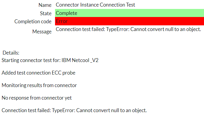

Trying to connect to IBM Netcool using "IBM Netcool _V2" OOB event pull connector getting below error:
Error:
failed to run 3PC java.lang.ClassCastException: class org.mozilla.javascript.Undefined cannot be cast to class org.mozilla.javascript.NativeObject (org.mozilla.javascript.Undefined and org.mozilla.javascript.NativeObject are in unnamed module of loader 'app')

Yogesh_Yadav
Thanks Satish for your reply.
Earlier trying with port 4100 so not working, while troubleshoot Netcool team ask to troubleshoot on port 8080 and it working now.
Thank you 🙂
