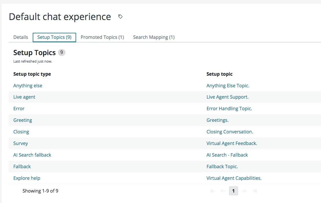

Hi Liyakhat,
You recently upgraded to San Diego, It is likely your greeting topics are removed from the settings.
1. Go to Conversational interfaces > settings
2. Choose virtual agent > custom greeting and setup
3. Open default experience and in setup, the topic tab update the topics
If the above is intact then try this kb article - https://support.servicenow.com/kb?id=kb_article_view&sysparm_article=KB0827959
