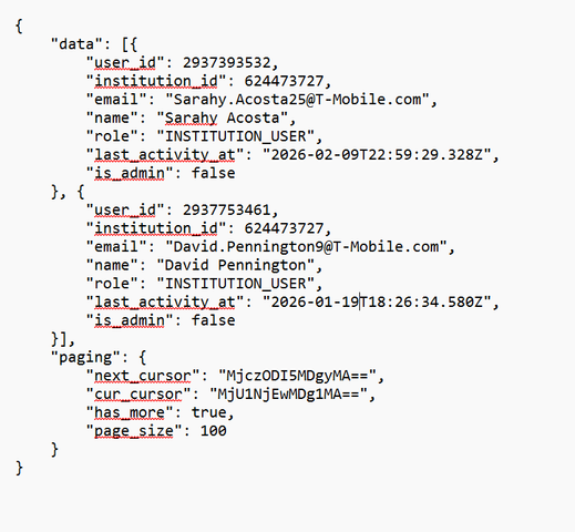

I’m working on a Data Stream Action in ServiceNow to integrate with an external API that uses cursor-based pagination.
The API response looks like this:
I have configured Pagination setup:
For the REST step, I am passing:
Getting the below 400 error:
{"type":"about:blank","title":"Bad Request","status":400,"detail":"{\"errorId\":\"e7ab5292-10dd-49e3-8711-2252e8651be7\",\"error\":\"malformed_cursor\"}","instance":"/api/v1/users"}
If anyone faced this issue earlier, please help me.
