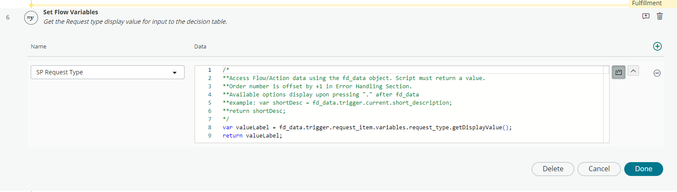

Hi WazzaJC,  Here is what I did.  In my case, I wanted to use a variable (Request type) to determine which assignment group gets the task.
1. Used the "Get Catalog Variables" action to get the Request type variable to use as input to the decision table.
2.  I needed the display value of the select box, so I created a Flow Variable and retrieved the display value to use for the decision table.  I could also have used in the internal value of the select box, but it isn't as self-documenting and harder to remember if it needs to be changed in the future.

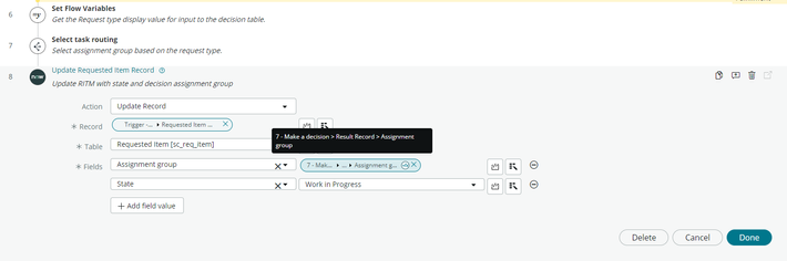

3. Used the Flow Logic "Make a Decision" to call the decision table
4. Used the output from the Decision table to set the assignment group on the RITM.

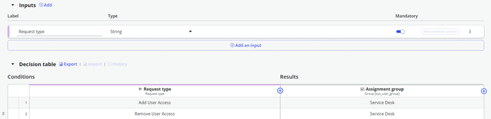

For the decision table, I used the flow variable as input, the conditions where the various options the flow variable can have, and the results are the assignment group.  The results in the flow can be thought of as output, that is then available to use in the flow.
