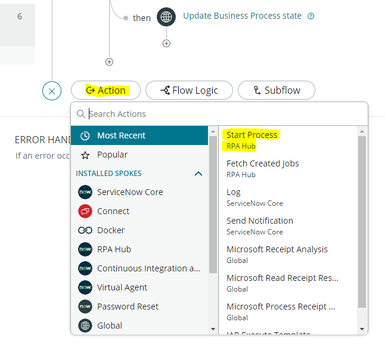

- Open the Flow Designer tool.
- Create a new flow or open an existing flow where you want to add the "Start Process" action.
- Click on the "Add Action" button to add a new action to the flow.
- In the action search bar, type "Start Process" and select the "Start Process (RPA Hub)" action from the available options.
- In the action configuration panel, you will see options to select the process name.
- Process Name: Click on the dropdown menu next to "Process Name" and select the desired process from the list. Please ensure that the process you want to select is published in the RPA Hub.
- Once you have selected the process name, configure any additional parameters or settings required for the action.
- Save your flow to apply the changes.
By following these steps, you will be able to add the "Start Process" action in Flow Designer, select a process from the RPA Hub, and make sure Bot process trigger mode should API & bot process should be published.
