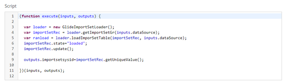

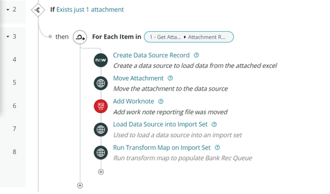

I must populate an RPA queue with the data from an excel file attached to an incident. To achieve it I'm using a flow with two custom activities, this is the flow:
This is the script for the "Load Data Source into Import Set" activity:
It has the data source reference as input and the import set sys_id as output.

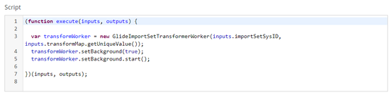

It has the import set sys_id and the transform map reference as input.
When executing the flow, it creates a data source with the file attached to it, but the import set is created empty (without a single row) and the transform map doesn't run; however, if I manually load the rows from the data source (by clickng "Test Load 20 Records") and transform the import set all the data is populated as expected in the queue.

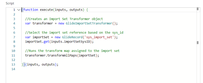

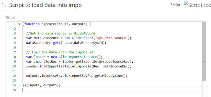

So, for the "Load Data Source into Import Set" custom activity, I have the data source's sys_id as input variable and the import set's sys_id as output variable. This is the fixed code:
And for the "Run Transform Map on Import Set" custom activity, I have the import set's sys_id, from the "Load Data Source into Import Set" activity, as input variable. This is the fixed code:
I tested it, and it processed a file with 7329 rows in 4.5 minutes.

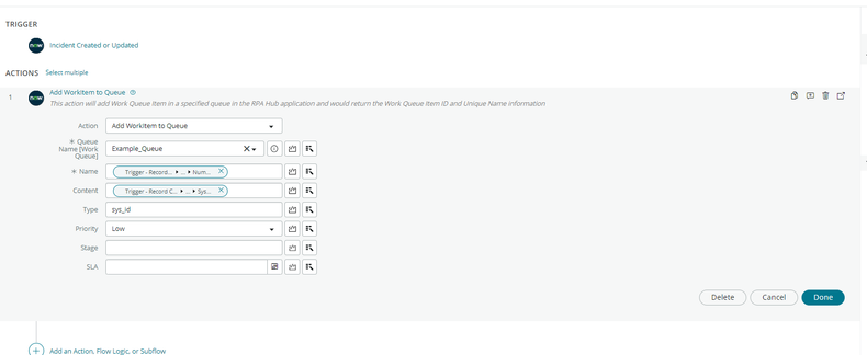

varadhi
Hi
Please find the example below.
Create a flow to retrieve the incident record's 'Sys_Id' and download the Excel attachment from the studio. Refer to the screenshots below for reference.
Find the screenshot below that demonstrates how to push data into a queue.

I've found the solution šŸ˜Š.
