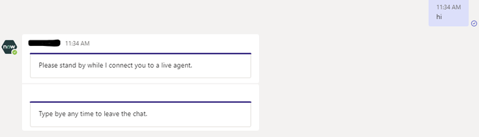

Hi all, I am using Virtual Agent (specifically in MS Teams, but I don't think that matters for this question), and am wanting to disable the "virtual agent" functionality and instead use just live agent. I've found that I can do this by using the "Live Agent Only" option on the Messaging Channels [sys_cs_channel] definition (docs). This works, and initiates a live agent as soon as I say "hi", eg:
