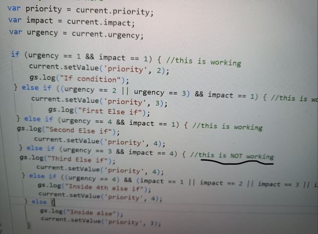

Hello all,
Because of some business need, we have in activated Priority look up rules on Incident.
Now I have written a BR, before - Insert and Update on Incident table and here is the script
I see that highlighted line of code is not executing, and I don't see the log message in the logs. Rest of all the log messages are coming up.
Can someone tell me what went wrong over there?
Lucky
04-23-2025 12:28 AM
Hi @Lucky1,
Add the log statement at the beginning and print the urgency and impact values. I think value is not matching with conditions.
Sagar Pagar
04-23-2025 12:30 AM

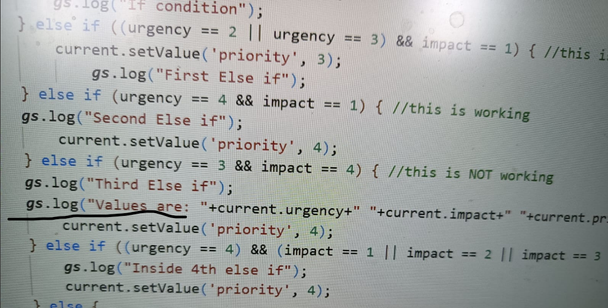

did you print the values of those variables just before you start the comparison i.e. the 1st IF
04-23-2025 01:00 AM
Hello Ankur and Sagar,
The new log, Values are: is also not coming up.
Actually, it seems, it is not going to else if condition I guess.
Lucky
04-23-2025 01:51 AM
I informed to add the logs at the very beginning
here
