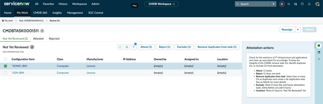

If you can add a screenshot to show what's displayed on a laptop it would help clarify the feedback for #5.

Tony Branton
If you're using Data Manager for Attestation then you'll see CI records to be attested presented in a list in the task as shown below.  You can configure the columns to display your desired fields, select one or more records and perform the attestation actions (Attest, Fail, etc).
If the text in this view is too small, you can use your browser zoom functions to increase the size.
