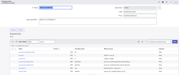

Hi Anders,
thanks for the reply, I'm not sure how to go about sharing a snip of the database configuration...do you want to see the table structure for a specific table?
thanks again
Hi @drslry2 ,
Snip similar to below:
best regards
Anders
