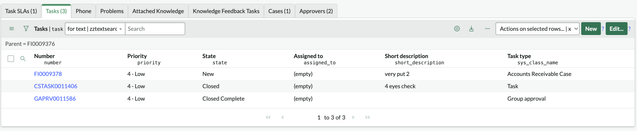

As you can see below on the example case, there is a child case, a task and an approval. The approval is fine as i found the reference to archive these related records.
However, i can not find the reference to archive the child cases and related tasks. 'Child' is listed however after selecting this and testing this, it did not work. Can anybody advise on what reference i can select to ensure the child cases and related tasks are archived aswell.

I found a solution in the end, the option in the reference field 'Parent in Task' allowed for archiving of the child case aswell as the tasks.

Hi @Michael Fry1 - thanks for your reply! yes the archive related records option is the 3rd screenshot I have provided and its where you can select what related records to archive at the same time, as you can see in the first screenshot I have set up Attachment, Email, Task SLA and Approvals. However I can't find reference to archive the Child and Tasks In that reference field on the Archive Related Records
