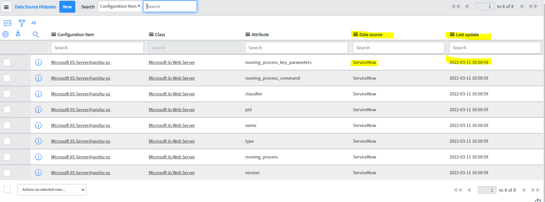

The overall IRE reconciliation is controlled from cmdb_datasource_last_update table.
You need to check this table .
Clear the table in your DEV environment. fresh run the data sources and observe as per the rule goes. You will get the clarity how the precedence is taking over .
Last update and Data source dictate which CI field will be updated as per the priority and data refresh rule(if defined)
