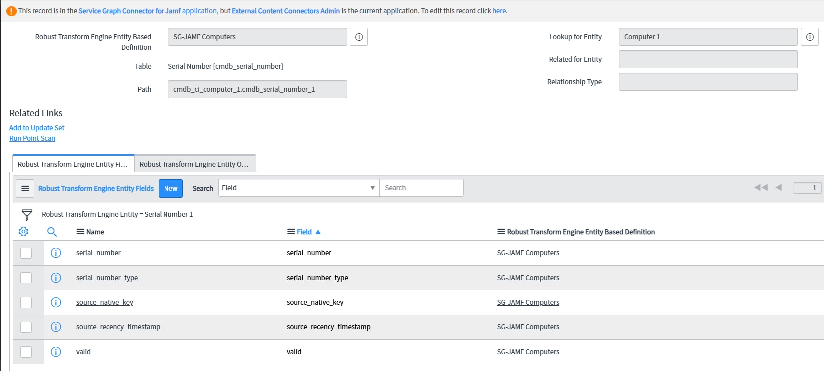

If you are using a connector it is built into the logic. See screenshot below that is from a JAMF where it shows the cmdb_serial_number and fields that get populated.
Hello @k_lutz , I dont think that CMDBTransformUtil will help me in creation of Serial Number table records populated., in connector/SGC as you mentioned in screenshot, its being explicitly mapped to cmdb_serial_number table by creating the Entities in RTE.
In import set, I think i need to explicitly to do On After script to populate serial number table. Let me know if you have contracting thoughts.
