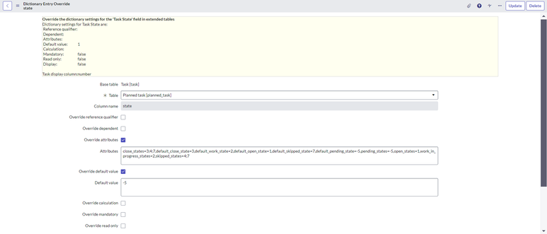

As part of the initial requirement, we renamed the state from 'On Order' to 'On Hold,' keeping its backend value as 9. The changes were applied to the Override dictionary for the Planned Task table. (please refer to the attached image).

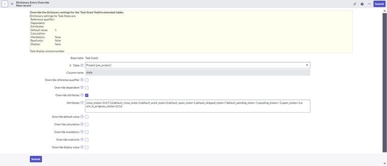

Now, based on your suggestion, do we also need to create a new Override dictionary entry for the Project table to ensure everything functions as suggested by you? As per that we have created new entry for pm_project table with state column in which where we can add our on hold backend value 9 in state bucket?
Looking forward to your guidance.
Thank you!

Hello @prasadsawan ,
If you have the state renamed for the Project Table, you need to change the override for the project table. The system looks at the best matching override (or dictionary definition in the end).
So a business rule looking at the state for the Project table, needs to be specified on the Project dictionary override.
If there would be no dictionary override, it would take the planned_task and if there would be no dictionary override there, it would take the task definition.
So, the answer is basically: yes. You need to specify your on hold state. Probably as an additional pending_state.
Hope this helps,
Hayo
