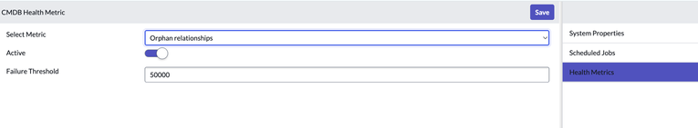

1. We have Failure Threshold defined in Health Metrics.
The CMDB dashboard displays the string 'failure threshold reached' when the number of CIs that are failing the metric tests, reaches the failure threshold set for the metric. CMDB Health stops processing for this metric in the current cycle, and therefore there is no aggregated health score for the metric.
It means that number of failures were more than the value defined in the Failure Threshold.

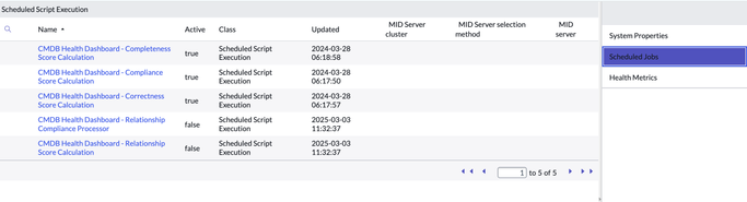

2. Regarding jobs, Yes we have Scheduled Jobs. These calculate the Health Metrics of the CMDB.
Navigation: ................service-now.com/$cmdb_health_properties.do
If the above information helps you, Kindly mark it as Helpful and Accept the solution.
Najmuddin.
Where do you find the health metrics and scheduled jobs as shown above?
If the above solution helps you, Kindly mark it as Helpful and Accept the solution.
Najmuddin.
