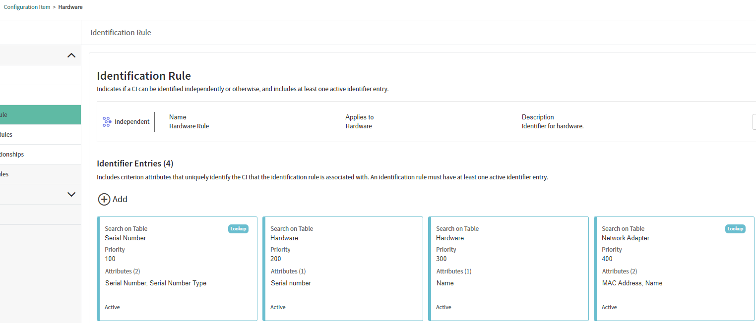

I'm trying to understand why the IRE doesn't believe there's a CI match when from my point of view it appears there should be.   I'm running the Identification Simulation on a simple payload.
If you look at the network adapter class there is indeed a matching CI with the same mac address and name.
The CI identifier shows the valid entry used to determine such a match.
Yet the Output Payload finds no match and therefore wants to instead insert a new record.   What am I missing here?  thanks!find_real_file.png
You will need to check cmdb_rel_ci.
The dependent relationship is defined as such:
Showing hardware as the parent, Owns::Owned By as the relationship type, and network adapter as the child.
The best way would be to go to cmdb_rel_ci.list to view relationships.  Add a filter where 'Type' is 'Owns::Owned By' and 'Child' is your network adapter's name.
If there is not a relationship in that query where the parent is your ROF... linux server then the relationship doesn't exist.

I have tried the same sample payload on an Out of box instance and it is doing a match on the rule with no change when retried with the same payload. Can you please check the dependent relationships that are on the network adapter? You can enable IRE debug logging and run through a simulation to find more information in the logs on why it's not matching.
Thanks so much.  Since I'm not seeing the behavior you stated in your reply and so we are on the same page, I've decided to follow your lead with an example using my own personal instance / oob.

There might be a  look-up rule missing on the cmdb_ci_hardware class which is causing this issue.
Unfortunately not....
