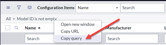

Can you post a screen shot of your query and/or right-click on the query and select Copy Query command from the popup menu? I want to make sure we are precise here. Also another possibility is that you have some Product Model records that don't have a display name set. Usually this should be set automatically but it is possible that some rogue import process created Product Models that don't have a Display Name set. In that case you would have a Model ID that is not empty and a Model ID.Sys ID that is not empty, but the field still shows as empty when displayed because there is no display value to display.
01-19-2023 03:16 PM
This seems to be a clear case of bad data that needs to be cleaned up but I'd still like to know why this data is so bad and to quickly identify that bad data as well as exclude the bad data (which I'm trying to do here). I need to take a closer look to see what they are doing with the imports and discovery that has these bad records.
last_discovered>javascript:gs.endOfLastMonth()^model_id.sys_idISNOTEMPTY^ORmodel_idISNOTEMPTY^nameISNOTEMPTY^manufacturerISNOTEMPTY
