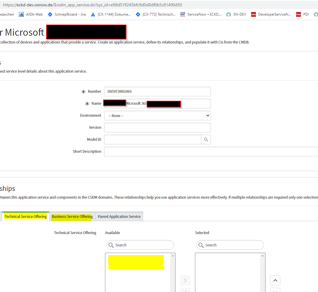

Hi there,
i have a lot of Business Service Offerings in my /service_offering table, but none of them are selectable under the application service view. Does anyone now what criteria something has to meet, that it will show up?

I can't see in the screenshot if this is your offering record.
Other things I can think of is check if service classification is set on the parent service - but if I recall correctly this should not be a requirement.

Hello Sesch,
Right now they are offerings which have the field "service classification" set to Technical Service or Business Service respectively.

Change the Service Classification of your Technical Offering to "Technical Offering" and then you should be able to select it in this slushbucket. For the other Business Service slushbucket, it should be set analogically.
