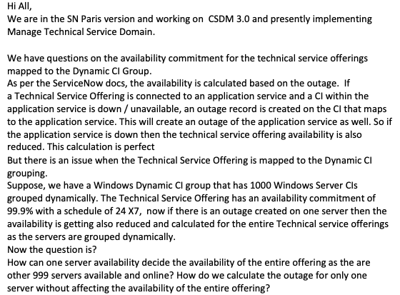

We are in the SN Paris version and working on CSDM 3.0 and presently implementing Manage Technical Service Domain.
We have questions on the availability commitment for the technical service offerings mapped to the Dynamic CI Group.
As per the ServiceNow docs, the availability is calculated based on the outage records. If a Technical Service Offering is connected to an application service and a CI within the application service is down / unavailable (Major Incident), an outage record is created on the CI that maps to the application service. This will create an outage of the application service as well. So if the application service is down, then the Technical Service Offering availability is also reduced. This calculation is perfect.
But there is an issue when the Technical Service Offering is mapped to the Dynamic CI grouping. Suppose, we have a Windows Dynamic CI group that has 1000 Windows Server CIs grouped dynamically. The Technical Service Offering has an availability commitment of 99.9% with a schedule of 24 X 7, now if there is an outage created on one of the window's server for 10 hrs then the availability is also getting reduced and calculated for the entire Technical Service Offerings as the servers are grouped dynamically.
Now the question is?
How can one server availability decide the availability of the entire offering as there are other 999 servers available and online?
How do we calculate the outage for only one server without affecting the availability of the entire offering?
