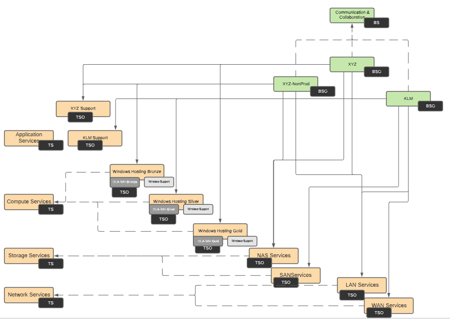

I do agree, it is a so-called bare minimum model. When nothing exist it is potentially the first enabler to build upon.
You could even do only:
  • Business Services and Business Service Offerings
  • Technical Services and Technical Service Offerings
And relate the Business Service Offerings to all Technical Service Offerings that are part of that solution. With this very basic set up you can:
Do ticket intake/registration, and route it to the supporting parties. Can be achieved quite fast.
