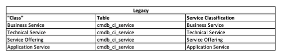

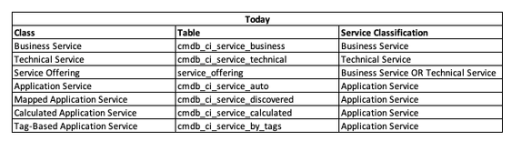

Hi Steven,
I think it is showing the history of Servicenow here. The legacy vs how it is today.
So by differentiating different class tables for the different classifications the classification itself becomes somewhat obsolete. At the Application Service level there is no purpose to classify it Business either Technical that is the relation towards the Service Offering and parenting Services.
It seems the conversion logic always makes it a value of Application Service which is ok(ish) however there is no reason to use it. It lost its purpose.
