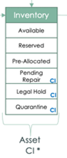

1. Inconsistency between Process Diagrams and Life Cycle Controls
The CSDM Life Cycle States process diagrams seems fairly straight forward, but then when I try to align these to what is setup in the Life Cycle Control (life_cycle_control) they don't seem to match. for example for Physical / Hardware CIs we have:
Yet in the controls table I see different status values:
Indeed neither Legal Hold or Quarantine are valid in the Controls table. This seems to be similar across the stages.
