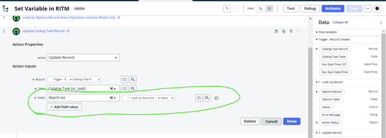

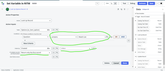

  1. Create a flow with trigger point Requested Item Created
  2. Look up record on sc_item_option table.
  3. Question contains Educational Unit Impacted. Don't use Question is Education Unit Impacted (Because every time a SC Catalog triggers with Educational Unit Impacted variable it will create a record with that value in Question).
  4. Now you have to opt that value of Education Unit Impacted which is recently created every time. Hence Order by Created and in Descending Order.
  5. Now update your RITM record in next action and update your RITM field with the sc_item_option Question Value.
  6. This will work for all Catalog Items. Here in example I have taken sc_task
  7. Also make sure that you are not creating any other variable which conatins "Education Unit Impacted" in name other wise system will not able to recognize which question needs to be picked for assigning value.
