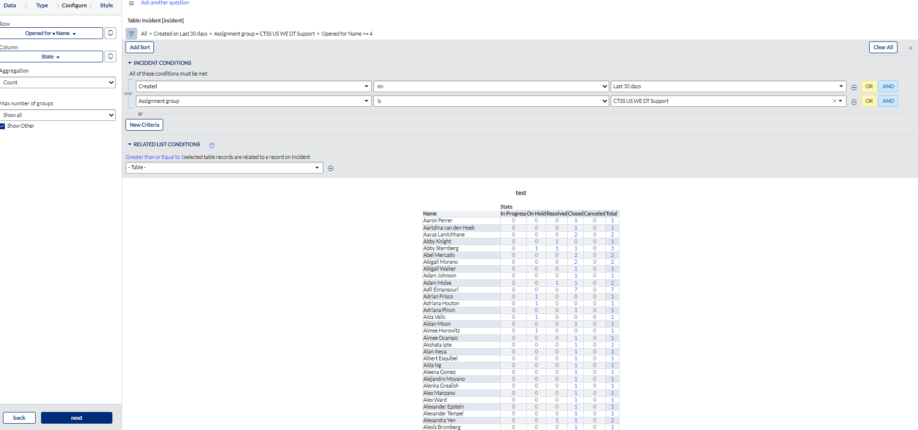

It seems as though aggregation is not an option for List type...I have what is in the attachment, but how do i narrow down to just ones with count over 4, i don't see an option anywhere?

This is perfect, thank you. I guess i'm missing/don't see the aggregation section?
Check if you selected the report type:
