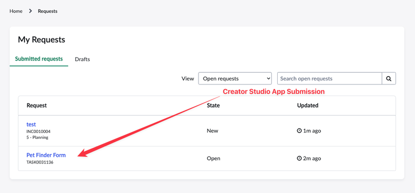

What type of view is available for the user that submitted a request through a creator studio application?  I can't find this anywhere.

Hello-If you are referring to the view that the submitter gets, that depends on your company setup. If you are using a Service Portal/Employee Center, you can add a filter on the My Request Filter (request_filter) page to point at your new table. This will surface those requests on the "my_requests" portal page.
If you do not want to set a filter up for each app/table, you could try creating a My Request Filter record for the "Request Task (sn_creatorstudio_task)" table. That should catch any table that's extended from the Request Task table that Creator Studio tables are extended from.
Is this what you were looking for?
