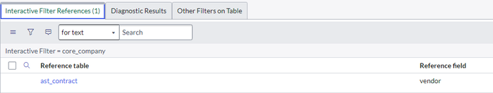

Hi @tomas posternak ,
Ok, if your report is based on the ast_contract and you e.g. would like to filter on vendor, you should create the interactive filter as a refence interactive filter based on the core_company table, as the ast_contract has a refence field to the core_company table for vendor name.
Furthermore, you need to remember which field you're reference in the interactive filter:
If you need further help according to the interactive filter, please share a snip of the interactive filter configuration, then I will be happy to help on error search the configuration.

Hi, It doesn´t works..
I´ve this 3 interactive filters
As table reference, i´m using the ast_contract, that shows me all the contracts that we have.
But when I put some information in the reference filter, it change the contracts that shows me.
So here I don´t know what information use to apply correctly the interactive filter.
Thank you.
