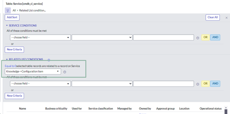

main question:
Creating a Report for seeing how many CMDB Services have a created KB, and not?
i have trouble finding how i can get this info, from services or from knowledge articles?
using that i can figure out how to create one that shows the ones that are created to a service, in a long normal list i can sort manually.
anyone can get me on the right track here? how do i do it?

You can create a report on table 'cmdb_ci_service', assuming that's the table and use the related list conditions to check on Knowledge (select Knowledge -> Configuration item) and set the default 'Greater than or Equal to 1' to 'Equal to 0' and it will show you all services where no article is written for:
Mark

02-08-2024 04:43 AM
This worked perfectly! this was the part i was shown and all correct! thank you!!
important notice, the equal to 1 thing he is refering to is the blue part above the drop down menu. easily missed
