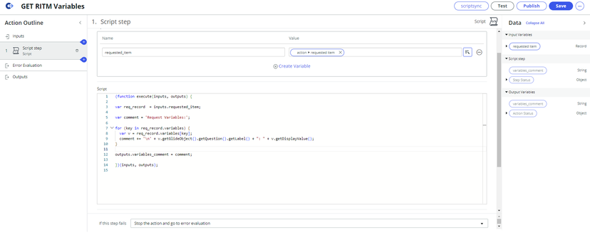

Not sure if you were able to figure this out already, but for others, you can do this in 2 steps using the flow designer. Note that I used some scripting, but only to create the output string.
1) Create a new action in flow designer and use the following code:
Be sure to add an input variable as a reference to the RITM table (look at the image below to see an example), name in this script is 'requested_item', but you can use what you want. Also do the same with the outputs variable but make it a string.
var req_record  = inputs.requested_item;
var comment = 'Request Variables:';
for (key in req_record.variables) {
  var v = req_record.variables[key];
  comment += '\n' + v.getGlideObject().getQuestion().getLabel() + ": " + v.getDisplayValue();
outputs.variables_comment = comment;
})(inputs, outputs);
2) Add the action to a flow that is triggered by a service catalog, or where you do a lookup for a RITM.
Now that you've added your action into your flow, you'll have a variable that you can reuse across the board for any item. The nice thing about this is it can be easily added into any item, or simply any time a catalog or case is created. Much faster than manually adding every variable into a comment.
Hope this helps people, I had a hard time finding the perfect solution but this worked really well for me. 🙂
