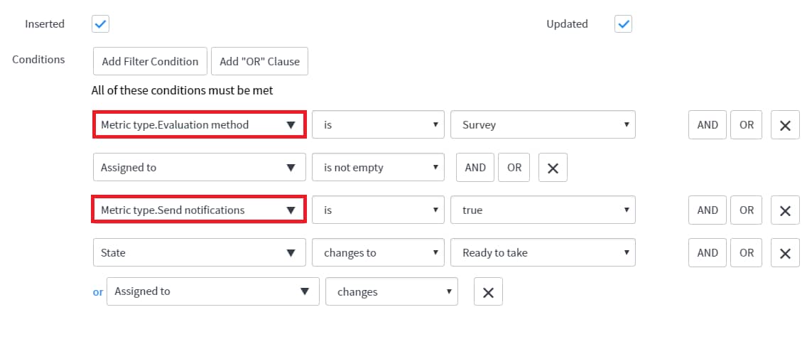

Hi Anurag
I am trying to create a new email notification for the new survey. However, I do not have a Metric type.Evaluation method and Metric type.Send notifications in the available conditions in the list.
This is what the OOB once looks like.
How do I add these options to the list of conditions?

Hi Mrudula
That is the problem though. I don't have Metric type>>Assessment Metric as an available option to select. Only Metric Type. Same goes for Metric type.Send notifications

Thanks for your help. The bit I was struggling was getting the bit after Metric Type. I asked someone else and they showed me that I had to go to the bottom of the list and it refreshes and displays the sub lists. They also told me to add a condition to the OOB Survey Invite to exclude the new survey. Just thought I would mention that for someone else that may read this for help in the future.
The info you provided was very helpful.
