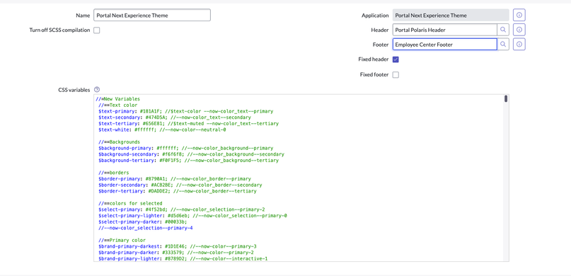

Actually i have requirement that need add a footer to CSM portal and in that on the left corner side i need social icons with the links as like ESC portal ?
Please help me to sort out this

You can use your employee center footer in your CSM portal, by following this steps:
Navigate to Service Portal > Portals
Open your CSM portal > Theme
You can add the footer in there: ( for example the Employee center footer)
Then navigate to Employee Center Footer and add the CSM Portal into the Portals field:
If you'd like to create your own footer instead of using the Employee Center footer, you can create a new one in the Employee Center Footer table.  And Link with the CSM portal in the same way as shown above.
