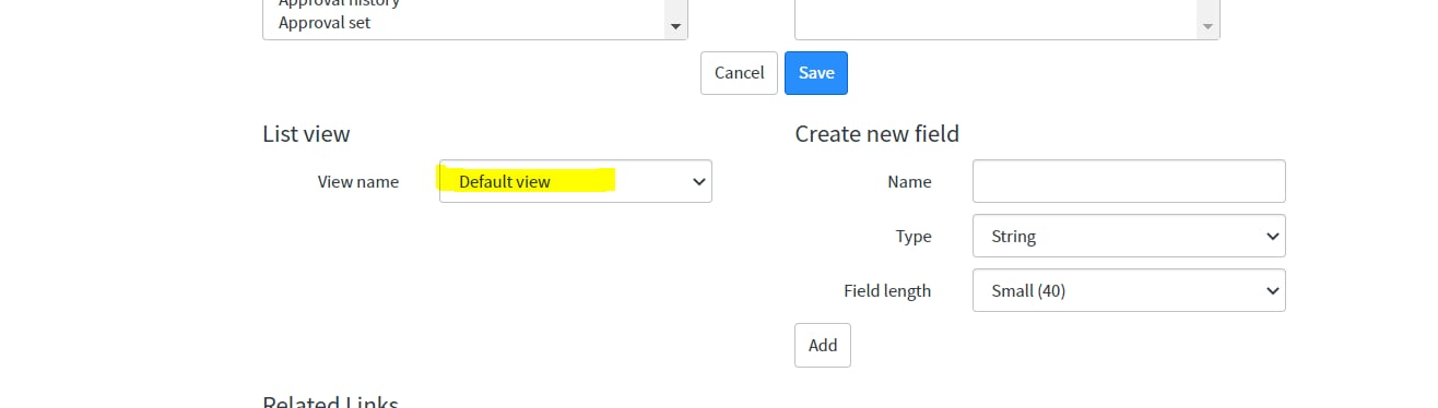

I have created a view named " default view" . I have to rename it . But there is no option found.
Can someone help me how to rename the view name which i created.

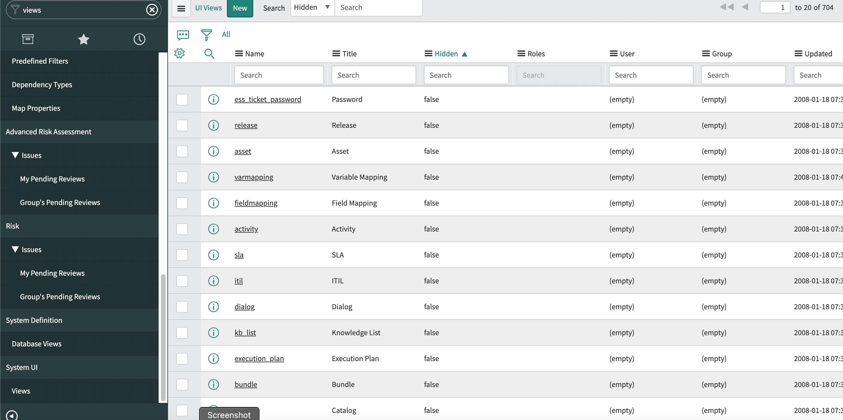

Did you try navigating to System UI >> Views & filter by view name & then update it accordingly.

Hello @Buddy 1 ,
1)Type in VIEWS in the left navigator
2)Search for your view and update the name

Hi buddy1
You can rename the view from the "sys_ui_view" table.
Application navigator > sys_ui_view > find you view name > change the title > update.
hope this helps !
