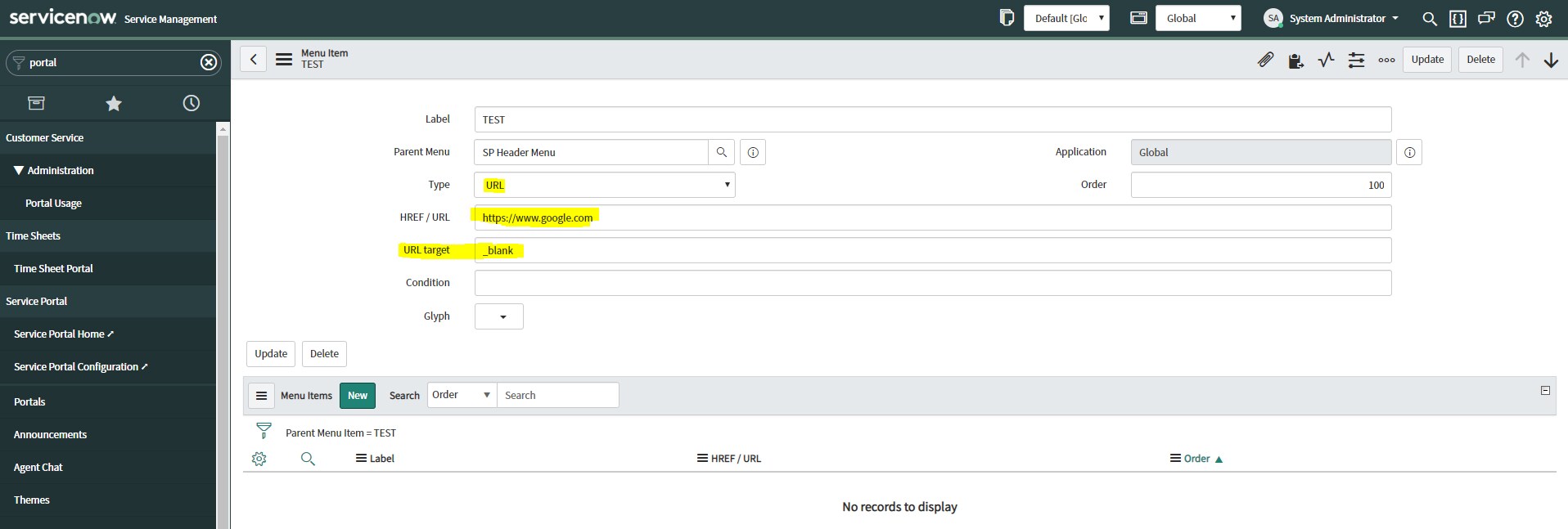

Sorry, just tested quickly in my PDI, there is no need to create a custom True/False field and change the menuTemplate code, simply put the following in the URL target field
_blank
IMPORTANT: check if you have any rule or filter in your browser that will BLOCK the new tab working or simply try using a different browser.
It works like a charm in my PDI, if you're in trouble, check my settings of the Menu Item:

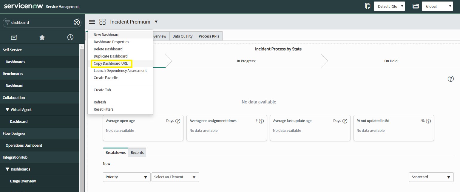

Just tried to put a Dashboard URL, it works fine in my PDI:
Please ensure to copy the URL from the Dashboard setting:
Also, as I told you before, try using a different browser or install Chrome from scratch, probably you have some rule installed in your browser that will block this.
