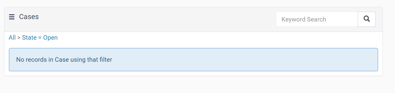

‎04-18-2022 06:25 AM
Thank you Filipe for looking into this!
I removed the customized changes from the OOB ACLs and created a new ACL for with below conditions bit still the 'Cory Testing' Account users are not able to see the case records. But users from account 'Coach' in above screenshot can see the case records in portal.
Any other ACL we need to create to make this visible?

‎04-18-2022 08:57 AM
earlier I added role 'sn_esm_user' in the ACL which the user already have but it was not working.
Now i updated the ACL role to 'snc_external'. Still the users belong to target account<'cory testing' in this case> is not able to see the record.
I tried debugging and found out this ACL is not getting evaluated at all. Shall i need to write ACL in some other level as well? Currently the above ACL is written for sn_customerservice_case.None.
Attached ACL snapshot for reference.
