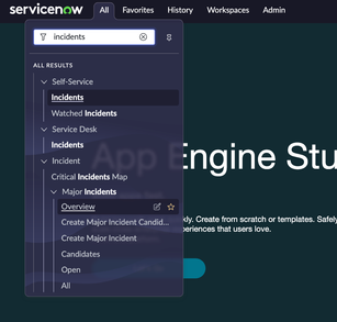

Hi @AdamUMC,
How is the user accessing the incident(s)? Is it via the Navigation menu for example or by passing a direct link or perhaps an email?
I'm assuming it's via the Navigation menu... As I'm sure you're aware there are (sometimes confusingly) a number of 'Incidents' links. One of which is under the 'Self Service' module as well as another under the 'Incident' module.
See below screen shot.
I'm sure you may have checked this, but for clarity, the link under the Self Service module, the first link to incidents defaults to the Self Service view. Does the user have access or can they see the 2nd 'Incident' link under the Incident module?
Have you edited and checked the Nav menu link setting where the view is set?
(Also thinking out loud, maybe check the 'User Preferences' for this user just in case)

Hi @AdamUMC,
