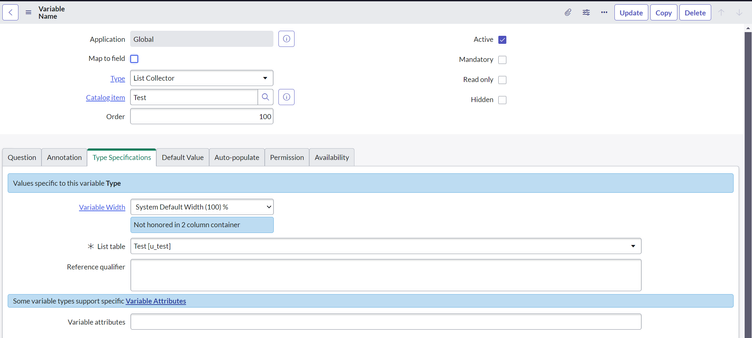

I have referenced a table A in the record producer list collector. The contents of table A are displayed on the record producer portal screen. Now the requirement is that a certain record of table A should not be displayed on the portal screen. This function can be achieved without deleting the data of Atable.

Hi @kack l ,
I'm not sure you can write JS code for this. But ServiceNow gave some OOB functionality called 'Reference Qualifier' to achieve your requirement. You just need to create a query to filter out your records that you don't want to show in the list.
Something like below,
javascript:'u_active=true'
This will show you only the active records in that table.

HI @kack l
 you can use the below code in the Reference qualifier
javascript;'name='A' '
