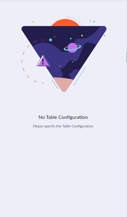

Has anyone had experience adding Response Templates to an Extended table? We currently have 2 separate teams working in CSM/FSM Configurable workspace one is on sn_customerservice_case and the second is extended off of that table. Both teams need to be able to use Response Templates but team 2 gets a No Table Configuration message. Both teams share the same UI Variant Record Page

I followed the Second person's suggestion and that seems to have gotten me closer, I now have a second Response Template Tab that is just always spinning

I finally figure this one out
I did not end up having to make a second response template tab, I was able to leverage the one that already was available to CSM Workspace and just had to add my extended table config to it.
The other thing I had to do to get this to work properly in Vancouver was add my Agent Assist and Response Template Table Configurations to the UX Page Property table (sys_ux_page_property) under contextualTableConfigMapping_main. This allows the Side Panel Tab Management Controller to find the config and solved the No Table Configuration issue when clicking the Response Template Contextual Side Panel icon on my extended table
Hope this helps anyone else that was stuck like me

Then you need to add Agent Assist and Response Template Table Configurations to the UX Page Property table (sys_ux_page_property) under contextualTableConfigMapping_main. You can follow the same format as the other lines, it needs to be exact and watch for the closing brackets if you add it on the last line. See Screenshot below. The top section is for Agent Assist and towards the bottom is for Response Template
