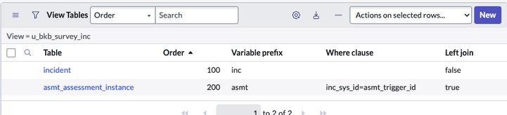

Here's a simple example with out of the box tables and fields.
This Database View will contain all fields from the incident and assessment instance tables. The assessment Trigger ID is the incident sys_id, so that is my Where clause. I want to see every incident, even the ones that do not have an assessment instance, so I have made this a left join.
