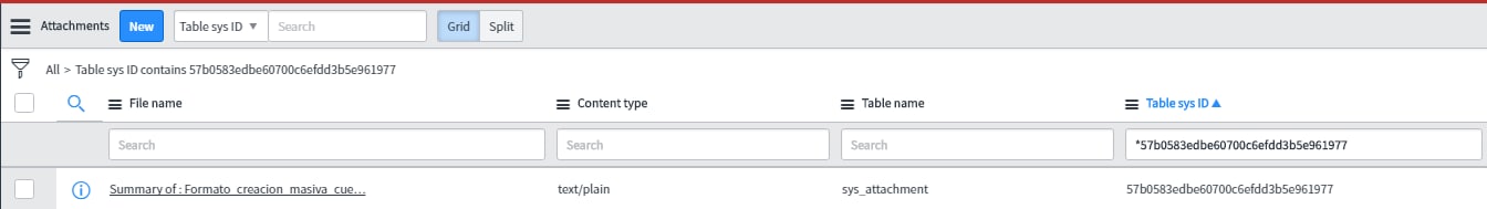

I need to add an attachment to one catalog item at service portal so the end user can download it. I have the next script to do it.
It takes a record from sys_attachment table (href="/sys_attachment.do?sys_id=57b0583edbe60700c6efdd3b5e961977"), but I need to modify that file and I go to the table and I can´t modify it or create a new attachment.
I read a lot of information this week, but I didn't find something to help me.
If you know where or how I can create a new attachment record or modify the existing, please let me know.

Yes, if you go to the list of attachments, and click it, it will download it. There is no OOB method for editing attachments. They really can only be downloaded and uploaded / deleted.
You can do it through script, but not manually like that.
