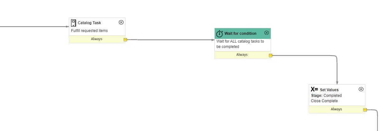

I had to add a "wait condition" in each workflow after my catalog task.
used advanced option.
// Set the variable 'answer' to true or false to indicate if the condition has been met or not.
var tskRec = new GlideRecord("sc_task");
tskRec.addQuery('request_item', current.sys_id);
tskRec.addQuery('active', "true");
tskRec.query();
if (tskRec.next()) {
answer = false;
} else {
answer = true;
Thanks Julie. I too had a wait condition but the script was different. I used your script and it worked. Once again thanks for the assist.
