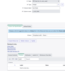

I created a table that extends Data Lookup Matcher Rules (I don't use Data lookup rules for this purpose). Now I want to use GlideAjax and a Script Include to look up my custom table. When the HR Service and the HR Case State match a record in that table, I want to add choices to the Sub-State field using addOption().
My goal is to show the Sub-State field with dynamic choices when the HR Case state changes to Work in Progress. The Sub-State field is an integer field and currently has no predefined choices.
Is it possible to add options dynamically with addOption and still have the form save the selected option correctly? When I tried this, the new Sub-state labels appeared correctly when the record moved to Work in Progress, but after saving, only the values were stored. It seems like these new choices, value in blue, aren’t being stored.

This is how it looks like when state changes to work in progress
Could the issue be caused by the Sub-state field not having any defined choices? and then it can’t be stored this way.
Sheldon  Swift
Hi @miro2 - At a glance,  you should be able to point Sub-State to Sub-State Label on your custom table so the choices are defined, then use your client script to remove (versus add) options  based on your matching conditions.
Sheldon  Swift
Hi @Sheldon  Swift thanks for your reply.
That should work. Thank you
