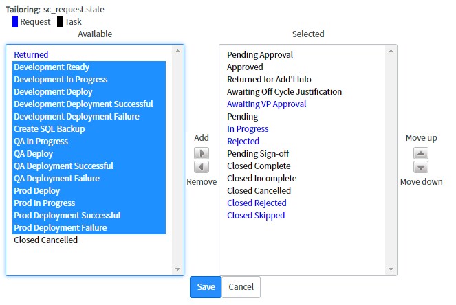

I have them all defined in the choice list and they are all listed in the Available choices - see highlighted entries. If I move them over to Selected then they always appear no matter what and if they reside in the available column i can control adding the options through the script but then i still receive the blue text even when using their appropriate values. Also setting the choices to Inactive = false also makes them always present.
DScroggins
As Sachin stated the options show blue as they are not defined in the table. Once you save the record the field takes the underlying value and then next time the record is loaded it checks the selected choice list to determine which value to display. As you do not have the 'Development Ready' option selected for the table then it will only show the value of 97 in blue as you are getting. I suppose one way around this is to add an onLoad client script to go get the display value of the field if not present on the table.
