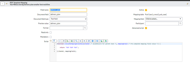

I am using PDF Template and PDF Template mapping. I am using Advanced Script for the mapping and want to return something which is added to the field in the PDF document to be generated.
If you use the Mapping Field field to map to the field in the case with the field in the template it works and the value in the field is added to the PDF document. If I use Advanced Script and just return some static text it doesn't work. Everything else is the same except changing to Advanced Script from direct mapping of fields.
What can the problem be? Any idea is of value. I assume it cannot be cross scope problems since it works with direct mapping. Restricted Caller Access should create a record with status Requested if that was related I think (right?). There is no such record.

The problem was that, of course, when it is advanced script the normal mapped field is not used. I need to get the script and execute it using GlideScopedEvaluator->evaluateScript().

Thanks for the feedback!
As you can see in my screenshot I am returning static text during the debugging just to avoid any other potential sources of error. I guess that would make 1, 2 and 4 not applicable. For 3 I run as admin so perhaps that is partly not applicable but scoping might be an issue? Not sure how to analyze 3 though, getting no errors in the error log and try catch isn't throwing anything either.
