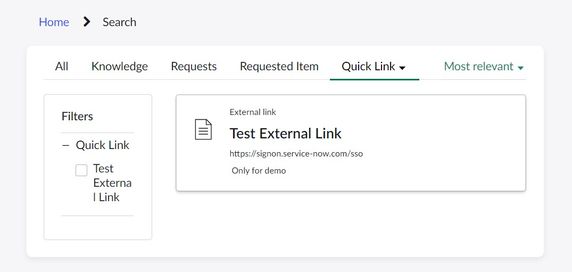

A customer has asked for Quick Links to be returnable in the AI Search on the Employment Center home page.
Strictly speaking this has been done successfully, and the result looks like this:
Point to note is that we're only concerned with Quick Links that are of type External Link.
The card shows a few mapped fields, and for the purpose of this demo I've included the related the value from the related External Link URL field. Up to here there is no issue.
However, clicking this card takes the user to the Quick Link record, and the requirement is to go to the actual link destination. I haven't found anything in the many components of AI Search that will do this, so obviously something needs to be created. Read lots of doco & forums, but nothing helps with this scenario.

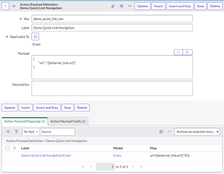

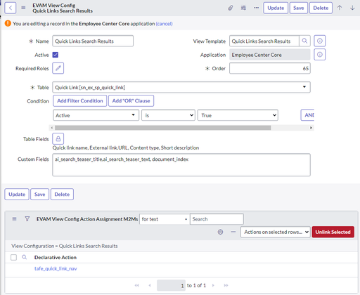

The solution here was in three records:
1. EVAM View Config
2. Action Assignment [aka Declarative Action]
3. Action Payload Definition
Process:
1. Open the EVAM View Config you've created to reach this point, in this case it is specifically for 'Quick Links Search Results'.
Note that the object we need to work with will be the Declarative Action in the M2Ms related list.
2. Open the table 'sys_declarative_action_payload_definition' and create a new record. The search results are set up to be clickable, and we want to tell this type of result what to do when clicked. In this case we are saying 'It's a hyperlink' (url) and the value for the hyperlink can be found, not in the Quick Link record, but in the 'URL' field of the related External Link record.
