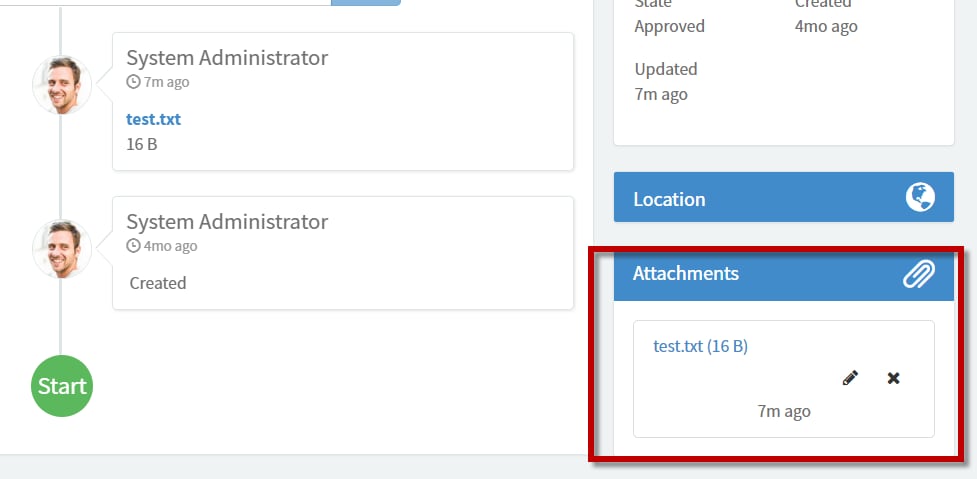

I had just tried (OOTB Dev instance):
1. Open an existing sysapproval Record, upload a test text file attachment.
2. Get the sys_id and table for that approval record.
3. Open a ServicePortal Page that has 'Ticket Attachment' widget. In my instance, 'ticket' page.
https://xxxxxxxxxxx.service-now.com/sp?id=ticket&table=sysapproval_approver&sys_id=007a44badba52200a6a2b31be0b8f525&view=sp
4. Verify that attachment is there.
Hope this helps.
Hi Bryan,
Yes I tried as you advised. It is working fine.
I am not sure where I am making a mistake. I am setting approver in workflow only. There is no other code running.
