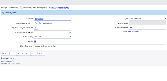

1. Using the documentation provided (https://support.servicenow.com/kb?id=kb_article_view&sysparm_article=KB0717946) we created a self signed certificate. We did not change anything about the provided instructions below beyond inserting the key provided to us from Grouper into the certificate:
"Upload jks which has jwt signing key in sys certificate.Java keystore with a signing key (Private-Public key pair) is generated by customer. Use the below command in the terminal to generate a java keystore with a self signed certificate."
keytool -genkey -alias snclient -keyalg RSA -validity 365 -keystore jwtdemo.keystore -storepass [GROUPERPRIVATE KEY] -keypass [GROUPER PRIVATE KEY]certificate.png

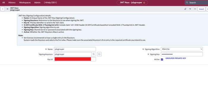

2. As this presented as a working valid keystore, we set up the JWT Keys as per the instructions:

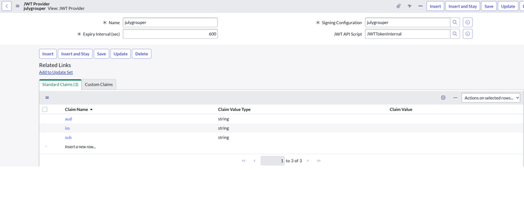

3. Lastly we pointed the JWT Provider at this key. No particular claims were specified or provided but here is a shot of that configuration screen:

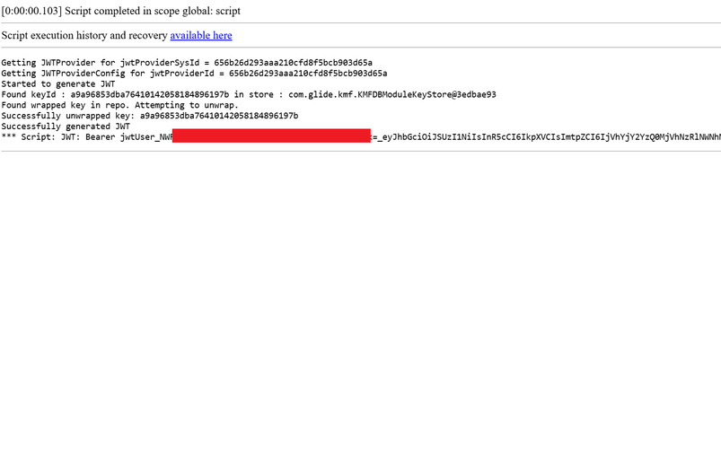

This generates a JWT for us successfully:
And I can verify that this is a valid signed JWT on jwt.io. I can verify that modified claims come over, and the expiration sets correctly so it does look to be generating the correct information. I exported the public key for verification from the certificate created in Step 1 using:
