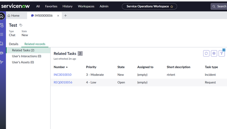

SANDEEP28
@conanlloyd I just tried creating record using record producer (can we help you?) and it got associated with interaction. Could you share screenshot from where you are raising record from record producer.
